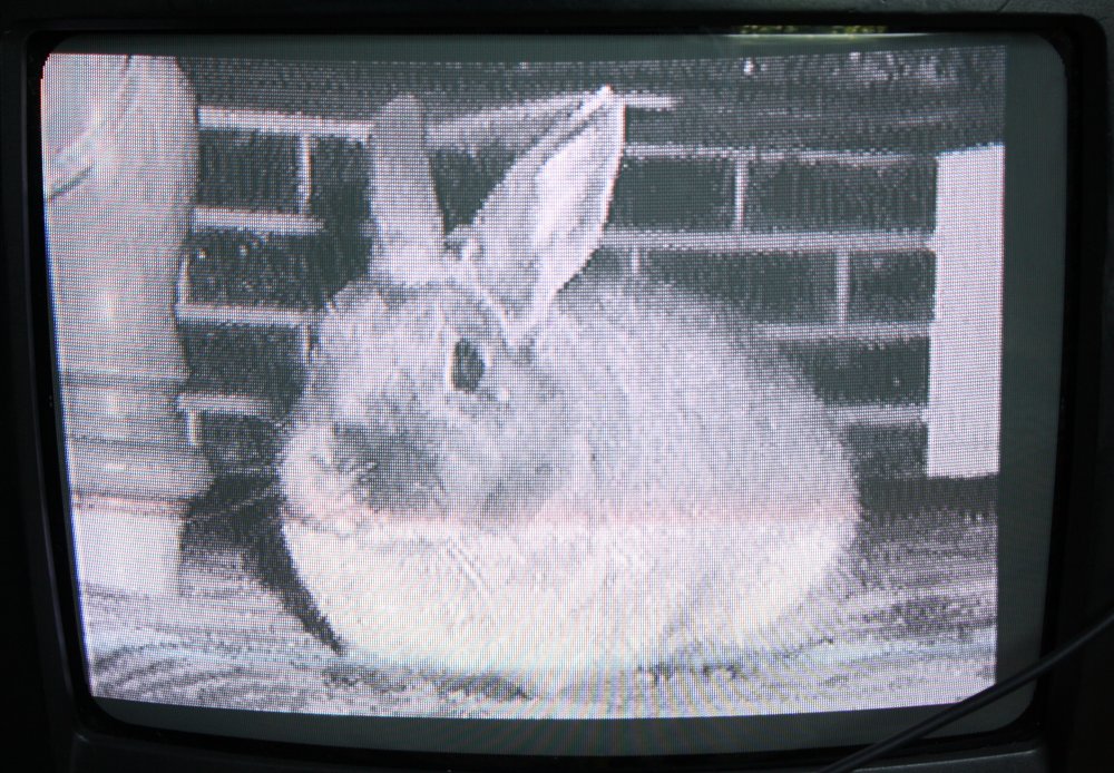

An annoyance back in the '80s and presently an annoyance now that I have my backup Compaq Deskpro hooked up to an Amdek 300A: CGA firmware that doesn't disable color when you ask it. Back in the day with my PC XT clone, I always had to issue a 'mode bw80' to get the CGA to disable composite color so I could read the text on my cheap green screen monitor. With the Compaq CGA card, it's even worse - it won't disable color even when you ask it. You have to force the BW bit in the mode select register. To add insult to injury, I hooked up a color composite monitor (from my Apple IIe) and it only displays in black and white - no color burst signal. Another color monitor had the same result. I don't even get to play with NTSC color artifacting! I suppose nobody ever used the composite output on a Deskpro. I guess if you were going to lay out that kind of money for a Compaq, you'd get their fancy monochrome dual-mode monitor. In fact, I have one on my main Deskpro, and it works great, but the backup Deskpro has to deal with the composite video.
Here is what I had to look at:
Unusable. Since I had just finished a fresh install of Compaq DOS 3.31, MASM 5.1, and MCS 5.1, I needed a coding project and this fit the bill: write a TSR to hook Video INT 10 and fix up the CRT mode register when a mode set happens. Hours later, after pouring over BIOS listings, CGA registers, and MS-DOS functions, I get this:
Interestingly, the Compaq CGA card only outputs three levels on composite: black, medium intensity, and high intensity. No 16 shades of grey. So none of the fun video modes are really worth playing with. Even 160x100 mode looks horrible.
For anyone interested, here is the code for my simple TSR MONOCGA.COM:

Finally, here is a glamour shot for that cool '80s vibe:
Which is the way both MGA and CGA cards worked back then--signals are TTL and you get one line for video (on/off for whatever color) and the level (normal/hi intensity). Real variability didn't start until the EGA--and even then, it still was TTL, but with 2 bits per color. VGA was analog output.

That makes sense. For some reason, I recall my XT clone outputting 16 shades of intensity out of the composite port. But that was 30 years ago and I can barely remember last week.
Dave...
Yes, new CGA has 16 different luminance values over composite, see here: http://nerdlypleasures.blogspot.nl/2013/11/ibm-pc-color-composite-graphics.html
Also, some CGA/Hercules clones can display CGA on an MDA/Hercules monitor with 16 shades of intensity.

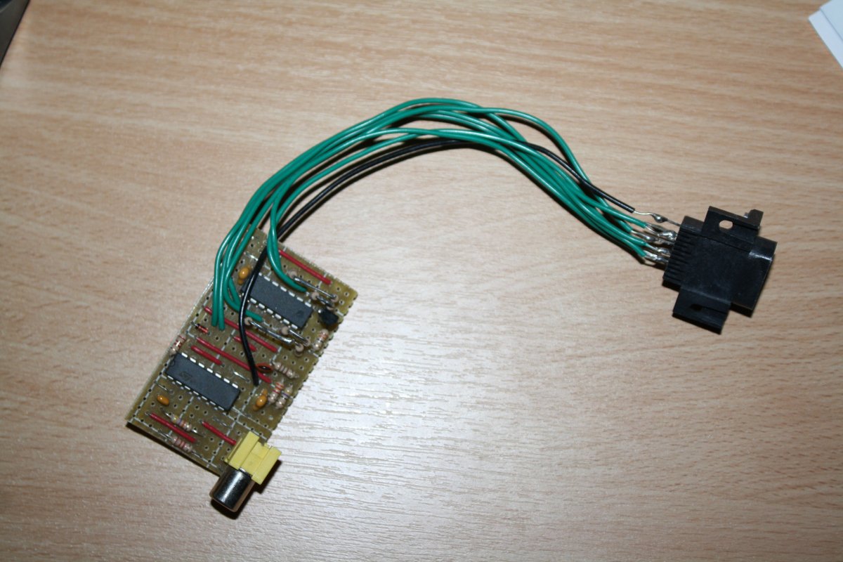

It's also not difficult to make a circuit that converts the output from the RGBI port to a mono composite signal - I've done this, and it works quite well.
I made one but its kind of jank (it works but only 8 shades and its not that optimized for warm vs cool palettes) I would like to see your's in order to improve mine
thanks
Mine is not optimized for warm vs cool palettes either - it just converts the RGBI index into a voltage linearly (so colour 7 is one shade darker than colour 8, not lighter as it would be if I was converting based on the luminance of the corresponding colour). That's because of the application I had in mind for it, but it should be easy to fix (just use the resistor values from the new CGA circuit). Here's the schematic, here's my notes and veroboard layout, here's a picture of the board and here's a photo of what the output looks like with an image optimized for it.
Edit: This circuit is actually much more complicated than it needs to be to just output a mono composite image - I also wanted my circuit to output a white pulse after the hsync in order to calibrate levels for a capture device. The OR gates, and the circuit that creates the delayed hsync pulses, can be removed. The new-CGA resistor values mentioned above are: 2K for R, 1K for G, 3K for B, 680 ohms for I, and 680 ohms for sync - adjust to taste.
ah ok I did a R-2R daq what messes me up is "warm" is R&G then "cool" is R&G&B so you get warm looking perfect and cool is blown out, or cool is perfect and warm is too dark so you either fiddle with a pot fine tuning it or find a middle ground which is still eh
