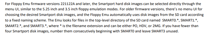

After reading as much as I could find on the combination I have..
Yes I can use my floppy emu in smartport mode to boot one 32mb drive image ...but only one at a time.
Even though the sd card can support 4 x 32mb images ....only one example smart0.po can exist in the root of the SD ...
..at least this is true for the Apple IIe
I think it only allows the 4 selectable images to be menu accessed in later Apples such as the 2c or 2gs.
So..I have concluded that I have to swap out the sd card to one with a different drive image in the root if I want to change the drive image.
..or drop in a replacement image and re-name it to smart0.po
Such that the yellowstone card can then boot the new image.

ah nice catch! Looking at the change log, appears to be version "2V" - October 28, 2021. Quite old.
If you're happy how it is now, then you can certainly stick with this version, or update if you want the latest whistles and bells like selecting hard drive images.
I would suggest you use the first one listed, "Apple II firmware, for Floppy Emu Model C or B, normal version: 240208A"

Ok ...bit the bullet and did the firmware update..
appeared to go smoothly..
I can now pull up a 4 drive position memory sadly not really readable in my photo..
but smart0.po is in position one.(0). just bleached out (a camera issue)
I can toggle through the other positions 1 2 and 3
I have a second drive image on the sd card containing Total Replay....which I have named smart1.po
but it isn't seen in the floppy emu display.
I assume this is a naming convention thing...
perhaps all drive images have to be named the same smart0.po ?
but this defies logic as you surely cant have 2 x smart0.po drives in the root of the sd card..
help with naming the images such that they would both appear in the emu menu ..but remain distiguishable from each other ....would be appreciated.
rgds
VS
Hmmm..
It would appear I'm approaching this wrong...
I have Bitsy in position 0 and labled as smart0.po and Total Replay in position 1 but left as an HDV file.
The Emu can load either extension now it would seem..
but it is less of a select from the menu and reboot...
More like unmount ...change and mount an image ...then reboot. ?
So I was going about it all wrong.
Even though an image is listed it has to effectively be 'mounted' followed by a power down and re-boot.
merely selecting it from the list and re-booting does not unmount the previous image and mount the new one.
but it does work...even though it had me confused.
