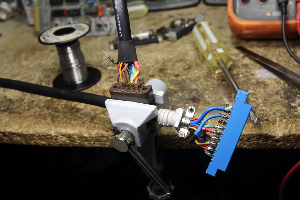

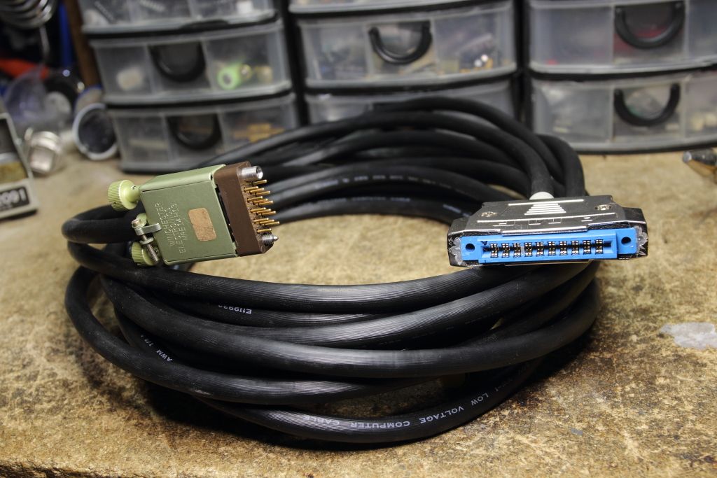

Meanwhile I was looking at the terminal cable I made last year and I still don't like it because it's kinda hacky and only five feet long, which isn't enough for a machine that's supposed to live in a rack, even if I put the terminal on a desk next to it. While I had that on my mind I came across a pile of decommissioned plenum rated VGA cable for connecting classroom ceiling-mount projectors to a desk at the front of the room. The cables are shielded and very long but then it hit me that while the wiring diagram asks for 22awg cable, I think this should work perfectly as we will not be running 1000 feet from the computer as opposed to 12 or 50 feet. If anything we can also then put the sync and clock signals on their own coaxial lines for additional shielding. I'll have to bring a sample home and test.
New display station cable is done. I'm much happier with this. I can probably make another 8 foot cable at some point but I've run out of AMP shells and need to order more.
