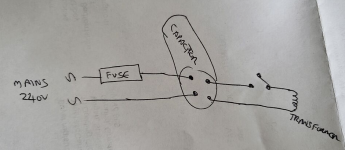

Got a fuse holder which is now working :), and I've tested the switch - also working.
Next I did a continuity test between the mains plug to the transformer (mains side) and nothing. Both from live and neutral are dead - no continuity from the plug to the transformer.
If you look at my crude diagram the connections both go through some kind of class XY capacitor. So I'm guessing this is fried.

It is called remove it and put it in the bin (and not replacing it)...
Mains live in series with the switch and fuse holder to one side of the primary (mains) side of the transformer.
Mains neutral to the other side of the primary (mains) side of the transformer (unless the switch is a 2-pole device).
Mains earth to the case - this is IMPORANT.
It probably is fried - but (just to check) test the mains transformer primary winding out to make sure it is OK. BEWARE, do not touch the metal probes of your multimeter. If the transformer is working, you can get a shock from the back emf that is still unpleasant!
See here for a typical arrangement: https://www.zimmers.net/anonftp/pub/cbm/schematics/computers/pet/8032/8032051-3.gif.

I thought it could be removed as it just looks like a noise suppression device - but wasn't sure.
It's a single pole switch. I've beep tested the mains primary and secondary windings and they all look good, also no short to ground.
Excellent.
These RFI filters were probably fitted to pass regulations in various countries. I think these filters (certainly on mine) are in the mains connector on the rear of the PET. Of course, if you have a wire going through a grommet - this cannot be the case!
Success - yanked it out and it looks like the transformer is working.
