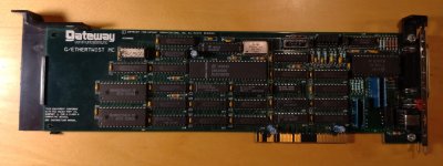

Do me a solid and use more light. I'll add this to the Gateway Communications page...
I don't have a decent camera, but I'll try.
Just one adapter, both are the same.
Interesting, the AT&T 7220 is on yours, but not on the ones I could find.

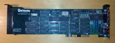

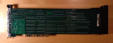

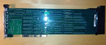

Couldn't do better with these cameras and lights.
Tried my old Canon Ixus camera:
Phone camera with flash:
Phone camera w/o flash:

Picture from phone w/flash is pretty good enough.
Added your pictures. It seems like the 9132 dated 8220-087 uses one big PLCC, while yours used more Natl Semi chips.

Gateway Communications I'll have to credit the images, identify components, and whatnot.

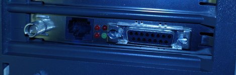

The image was clear enough to identify the LEDs for each status.
What is the component ID for the AT&T T7220? The angle sordid obscures it. U28?
Something became blindingly oblivious. The HP27246A has a RJ11 for phone line connectors [ease of swapping in Ethertwist] and RJ45 for UTP. The Gateway Communications Ethertwist uses AUI -AND- RJ45.

Looking at @6018, I see it has a SIMMple hex progression, so diddling the IRQs or I/O should be possumble -BUT- your card [and all GC cards] have non-populated edge connector positions.
I must purify myself in the waters of Lake Minnetonka... Compare your card's connectors to the full slot...
Ah sorry here's a pic.. Looks same as http://ps-2.kev009.com/ohland/Ethertwist/Gateway_8220_Ports.jpg
U29
