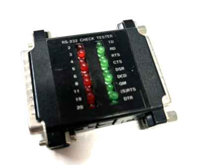

Sorry about the pause in responses....I can focus on this project again. Turns out the RS-232 tester I linked to on Amazon.ca isn't available anymore.
Would either of these be good:
or
The second one has more lines displayed....but the shipping to me is $27CAD!!
The one you ordered will be fine. Those LEDs are bi-colorl. So, they will light up either green for a LOW signal or red for a HIGH signal. The versions that have more LEDs are just separate green and red instead of having bi-color.
Plug the tester into the SuperPET and see which LEDs illuminate and what colour.
Then do the same for the WiModem232.
Post the results (or post the photographs).

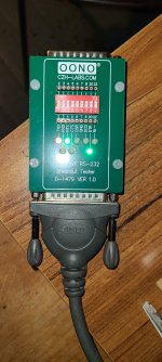

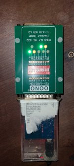

Ok...got the RS232 tester today.
On the Wimodem232 (which is in a TicTac container):
And plugged into the straight-through serial cable coming out of the SuperPet:
