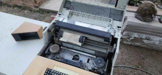

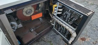

I ended up buying a System/32 in South Carolina on Facebook marketplace. I'm disassembling down to the frame now, and plan to grind off rust and repaint it.
Good:
  • All the logic cards are present
  • Rust seems to be surface only
  • The mirror box for the display is present
  • The giant hard drive looks great and was locked
  • Keyboard and control panel look good
  • All the wiring was connected to the right places
Bad:
  • The floppy is missing the motor
  • The print band is missing
  • The power supply looks to have been gone through, but not repaired. Someone labeled one of the transformers bad.
My plan is to get the frame cleaned up, new casters, and repainted first. Then I'll clean up and reassemble the components. Then I'll slowly go through the power supply, board by board. I will replace bad components with their modern equivalents and see if I can test each section on the bench before attempting to bring the machine up.
