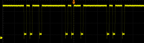

Pin 22: Regular activity, seems to repeat three pulses in a repeating pattern:

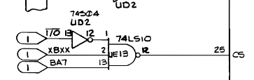

I'm thinking this may be a thread to pull on? The schematics show this pin as being fed by three inputs NAND-ed together:

Okay, the three inputs to that NAND gate are these three:
I'm at a bit of a loss as to what they represent, though.
The one labeled "/I/O" is connected to a pin we've measured earlier; pin 16 on UE12, which you said indicates activity in the EDIT ROM ($Exxx), but I don't see why accessing the EDIT ROM would also be accessing the CRTC?
The one labeled "x8xx" is a little weird, but since it's connected to BA8,9,10,11 from the address bus with those logic gates there, I'm inferring from the name that it goes high whenever the selected address has an "8" as its second hexadecimal digit?
Combined with BA7 being a direct input to the CRTC's NAND gate, then, I suppose the CRTC is selected (i.e. the NAND gate outputs LOW) whenever:
  1. Any address is selected in the range $x880 - $x8ff (weird that the first digit doesn't matter)
  2. The /I/O input is LOW.
Ahh... I see now that the /I/O input is itself driven by the UE12 decoder, which is in turn driven by some of the other address bits. That's clever! So that's how it maps certain areas of "memory" to other things (I'm assuming this is also how it talks to peripherals and things like that).

Alright! So, at the moment we're trying to figure out why the CRTC chip select (pin 25) is never getting activated (active LOW). We figured out that it is set by a 3-input NAND gate, which is fed by:
  • UD15 pin 18 (BA7, i.e. bit 7 of the buffered address bus)
  • UE14 pin 8 (labeled "x8xx", this goes HIGH whenever the selected address follows the pattern $x8xx)
  • UE12 pin 16 (labeled "/(I/O)", this pin goes LOW whenever the selected address follows the pattern $Exxx).
    • This signal is fed into the NAND gate through an inverter
All the above tells us that:
CRTC pin 25 = NOT ("BA7" AND "x8xx" AND "I/O")
i.e. we expect the CRTC to be selected when the address is in the range $E880 - $E8FF.
