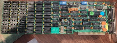

Hello!

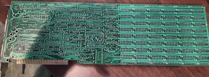

I'm trying to repair/rebuild a 5150 system and when I got it, it included the card in the photos. The silk screening on the back looks like it says, "OTECH GOLD II" or possibly "OTECH GOLD IT", copyright 1984. In addition to the RAM (MCM6256AP12), it appears to have a RTC, and the ports on the back are two DB15 connectors, one male and the other female. There's no silk screening next to the header pins up between the two DIP switch blocks.
Google Gemini thinks it is the following, but I don't completely trust it. If anyone can help with identifying the card in an attempt to find the dip switch settings, it would really be appreciated!
Thank you,
James

Well it's certainly a ram expansion up to 640K, plus an RTC and one serial port (with the wrong port type) and possibly one gameport and one parallel port, judging from the internal 26 pin header. Otherwise without searching myself I can't verify the rest but it is at least correct to call it a multi-I/O combo card.
AI should be required to cite sources. I'm pretty sure Gemini just invented the "Gold IT specialty." A complete PC parallel port requires 17 pins plus ground.
It's far more likely that a DB25 parallel port connects via a ribbon cable to the 26-pin IDC connector on the card, the male DA15 port is a serial port, and the female DA15 is a game port.
Serial ports are usually DE9 or DB25, but there is an 8250 chip so one of the ports must be serial.
The clock chip is an M5832, shown clearly in the photo. I don't know why the AI is guessing about that. You can find a clock driver here. I would start with David_M's generic reader.
