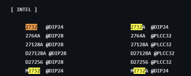

(THIS IS EDITED FOR ACCURACY) The T48 doesn't support the 2532, I think it does support the 2732. Here's a screenshot of that.

So my guess is that in any case the PET cannot use 2732 ?

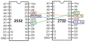

    The question is : will my just acquired T48 accept to write the 2532 as it seems to accept to read them (the T48 = TL866v3 should able to write 25V eproms ? but I will only be able to set the T48 in 2732 mode as for reading)

I'm not sure the schematic on message 48 will work to program and read a 2532. It has to do with pin 21 (Vpp) needing to be at +5V during a read operation. Let me look into it. For the time being do not erase your 2532 chips.
One thing you can do is to program a 2732 to work as a PETTEST4. Note that the 2732 is a 4K Byte EPROM while PETTEST is a 2K Byte file. But due to a happy quirk of pinouts, it will work in the EDIT socket but only if you program the 2K contents into the upper 2K of the 2732 address space i.e., from Hex address 0800 to 0FFF. This is an offset of the starting EPROM address of 0800 Hex.
If this does not make sense to you, read about starting 'Offset' in your T48 manual. I do not have a copy of the manual.
Stan,
It has to do with pin 21 (Vpp) of the 2532 needing to be at +5V during a Read operation while pin 20 of the 2732 will be held Low during a Read and Verify operation by the programmer.
The 2532 EPROM is not specified to work with Vpp at a Low level. See the spec sheet: https://www.qsl.net/n9zia/vision/TMS2532.pdf
Adding a diode and a resistor to the adapter should fix this issue. Let's have Daver2 take a look before you try it. I don't want you to blow up your T48 or the 2532.
With this circuit, the 2532 Vpp pin will be close to +25v during programming, but pulled up to +5V during a Read or Verify due to reversed bias on diode when pin 20 of programmer is at Low.
EDIT: Nuts that may not work either! The Ipp1 current specification for Read operation with Vpp at 5V is 12 mA Max. With a 1K Ohm resistor there will be to much voltage drop across the resistor. Maybe a diode rather than the resistor? It would have to be a diode with a low forward voltage like a Schottky diode. This adapter is not looking like a good solution to programming a 2532...
