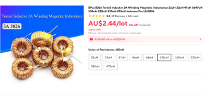

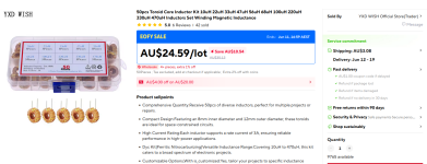

Hi again all readers of this thread. Well I thought I will do a search on net for 10UF Inductors and came up with quite a few cheap variants of Aliexpress that pretty much match the design mentioned
Primary difference seems to be core. One lot are yellow/white core others are Green Core.
so looking at Aliexpress I see
but by time I am shipping I feel a better option is to buy a a kit like these of 50 in total. inc shipping this equates to Aus$0.55 each.
So this is a serious option, if I cannot find one in a an old PCB lying around in my junk pile.
Way better than winding one myself. and they are same core size as is mentioned in above article
