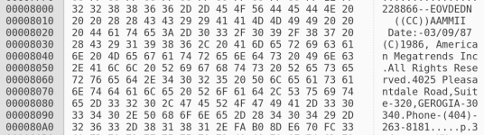

@Vortex286 See my previous post. It was still waiting for moderation when you posted. I think I did the bad dump with a tool called biosdump? But I can't remember. The new dump was with NSSI and looks much better. I will try to feed this new dump into IDA to see what it says.
This time all odd bytes are FF and the even bytes are almost 00 until offset 8000h
Yes, and at 8000h there is the EVEN/ODD eprom chip markers(which I assume would be at the beginning of each eprom) and the AMI copyright. Which is why I said it is a 32K bios. Even though NSSI ripped the full 64KB block.
It's pretty weird to have repeating characters in that picture...
E.g.
228866 and ((CC))AAMMII
If the BIOS is 32K then why not use 2 16K ROMs or purposefully leave the unneeded portions of 32K ROMs as a swath of FF bytes?
Are you saying that the dump tool you used this time is interleaving two copies of the real BIOS?
OP didn't dump the actual EPROMs, he used a tool that just reads memory. Which is fine for a 286, because the BIOS is uncompressed and directly mapped to memory.
The repeating characters are expected on interleaved EPROMs so that if they are dumped separately, one would start with "286-EVEN (C)AMI" and the other would start with "286-ODD (C)AMI".

Even if I did dump the eporms, on merging them you would get what I posted, double characters and all, but only the top 32KB.
