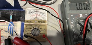

Using some spare tubes left over from the original build, I've prototyped a VFD driver setup. This uses only a standard +5v supply, incorporating a small buck-up module for the +40v. I've avoided other active parts, just using four resistors. A resistor divider (from +5v) provides 1v and lifts the filament to a +3.3v reference. The grid at ground cuts off the glow without needing a negative supply. If multiple tube filaments and anodes are connected in parallel, reduce the resistor values proportionally. On my breadboard this gives exactly 1.0v DC across the filament. I can see some fade-out near the top end, but this is OK for my purposes. The logic input is assumed to be 0-3.3v range. I used the maximum possible grid resistor just in case the tube shorts to protect the input logic. Also added the optional anode resistor for failure protection. Any comments?
Prototype schematic
VFD on breadboard
Filament voltage confirmed at 1v.
