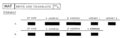

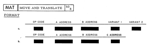

As I'm reviewing my instruction extraction, I ran across something in the Programmer's Manual sections on the instructions. For the most part, the FORMATs are showing both the Easycoder input format as well as the physical layout of characters in the object code (in memory when running). But there are some instructions like MAT and MIT that have this:
where (I now believe) "format b" does NOT have anything to do with the instruction as it lives in memory - that is purely an input style for Easycoder. I was previously assuming that this indicated how the instruction might look in memory and was doing some odd things to extract through it, but I now suspect that Easycoder just converted "format b" into "format a" when generating the object code and only "format a" ever exists in memory. Maybe this is a "duh" response for everyone else, but I had been taking these FORMATs too literally.
I'm pretty sure most other instructions are showing the memory layout, even if that's not the intention of these diagrams - at least based on running and examining Rob's MACHIN code. But cleaning this up will remove some ambiguity from my extraction code, at least for these two instructions. There are still some special cases during extraction, such as SVI and of course SW/SI, but I'll be reviewing all of that. And I'll need to update my Easycoder and Unix v6 assemblers to do the conversion. That's a bit trickier for my Unix v6 cross-assembler as it will want to store a relocatable address for the "C ADDRESS" field, and so I may have to do the conversion during link time - which is abnormal. It will take some thought.
