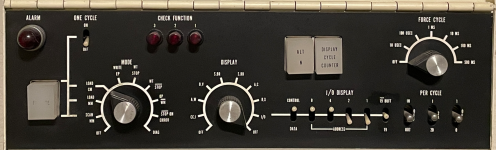

Those pushbuttons are pretty sturdy, and I can still hear the sound they made in my head (or if I press a few on my H2015 control panel, but I don't need a reminder! :) ). I can even tell the difference between the momentary type and the on/off type (like the ones used for the SENSE switches)...they had a different sound and feel to them. Mine are still working after all these years.
He said that when testing the machines with their test software they just kept hitting those same buttons over and over again
That's something I had a discussion about a few weeks ago with my dad. I was asking him about the FORCE CYCLE knob on my H2015 control panel (and in others). It has positions for 10us, 100us...500ms on it (I decided a pic is worth more...see below) and I was wondering what it was used for. He said that you would punch in a program and use that feature to basically repeatedly reset the CPU after every 10us, 100us...etc. Basically a STOP+INITIALIZE followed by RUN after letting the program run for a period of time. I suspect there were cases where just using a branch instruction wouldn't work. For systems without that feature, like the H200 control panel, there was a board you could insert into the CPU to essentially do the same thing. Many of the systems with consoles had it built into the control panel.
Bill: That control panel appears to be solely for running diagnostics rather than operating the machine normally, but the larger machines were operated using consoles instead of the control panel used on the basic H200. To rerun tests initialising ensured that each test started off from the same machine state regardless of how the previous test left it. Nothing could be assumed if a fault was suspected I suppose.
That's correct, it was mostly used for maintenance purposes, although you could use it to clear memory as well in conjunction with the SYSTEM CLEAR button. I learned a little about some of these features initially on an H2050A and later an H3200.
Even small systems like an H200 had the console as an option but I think it still required a control panel like yours as it didn't have the reduced version of the control panel like mine (see pic below, I don't recall what the two buttons above the keyboard were) Not all of those smaller control panels that were part of the console option included a diagnostic section like mine does (I want to say the H1200 didn't)...they just had the lower section which basically included the bottom row of buttons on your panel.

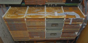

The drawer in the picture appears to contain a memory and if those memory modules are 4k ones then it would be a fully populated 16k drawer as used in the H200. However it is shown with the logic boards in the vertical working position whereas in the H200 lowboy cabinets the drawers didn't slide out but rotated out so that the boards were horizontal during maintenance as my pictures always show my backplanes. The entire layout of the backplanes is designed to make working on them easy that way up whereas with the drawer in the position in your picture everything is on its side and one would go mad trying to work on that for any length of time. Certainly I couldn't wire up an entire backplane with it that way up. Was that drawer possibly in a display case rather than in a computer? I ask because I don't know what the covers on them looked like and I need to make a cover for mine so that I can install the cooling fans and run everything for long periods without it overheating. Obviously on the odd occasions that I saw a drawer open in our H200 Brian was working on it with the cover removed, so I never noticed what they looked like.
The photo of the memory drawer is in the "working" position. Sorry for the fuzzy photo but it's around 50 years old. Here is the entire photo for better context:

Exactly, and some had the maintenance panel under a hinged door at the top as you can see in my H2015 control panel. Not all had the maintenance panel and some had different configurations when they did. The coolest, IMHO, was the H2050A which also had a row of small incandescent bulbs for the address bits, much the same as the big control panel does.
Not a great pic of it, but here is a H2050A system my dad had at one of his warehouses. If you look closely, the maintenance panel on the control panel is noticeably larger than for the H2015 to accommodate the row of incandescent address lights which are the same ones used on the H4200/H8200 control panels (snippet below). I still have the H4200 control panel.
Ah, now I understand. It was a picture of a lowboy cabinet with the side panel removed so that the memory drawer at the right hand end was visible. That explains the peculiar frame visible in the close-up.
