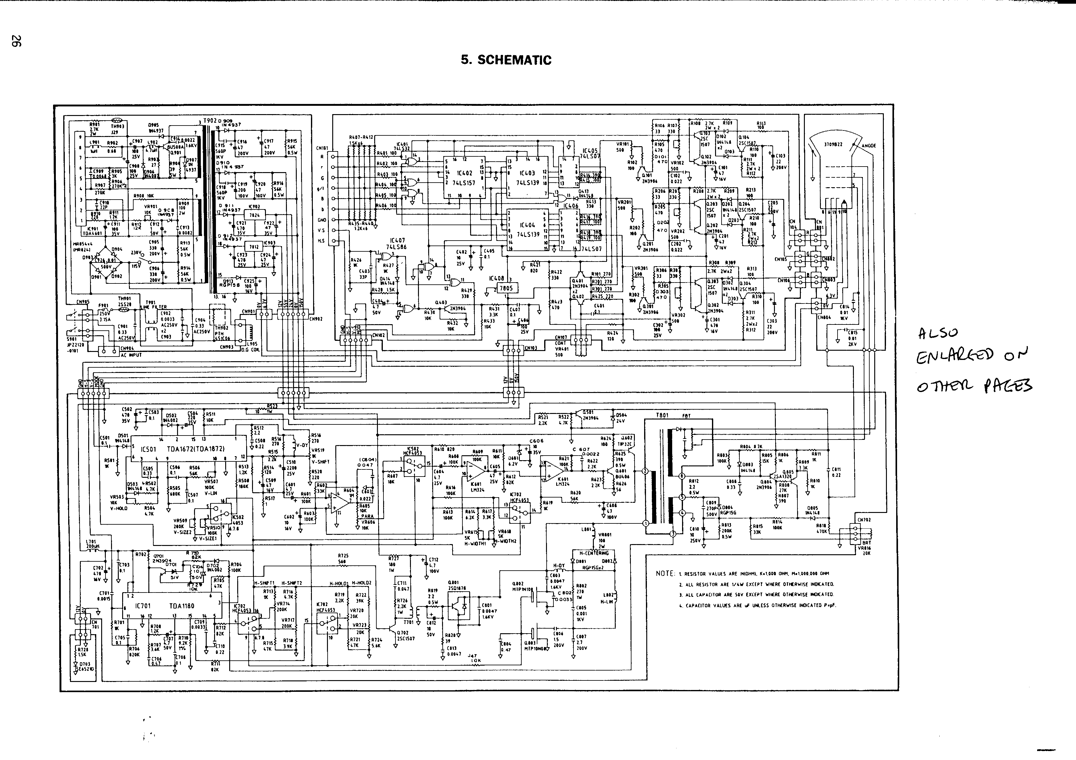

I want to try to find solution of my problem from another end. My problem - why CRTC controllers had exactly those settings, they had? I'm not familiar with old TVs and monitors. I've found old EGA monitor's schematic. It's sync circuit is based on TDA1180. I've dug into it's spreadsheet, but there isn't any detailed explanation there.

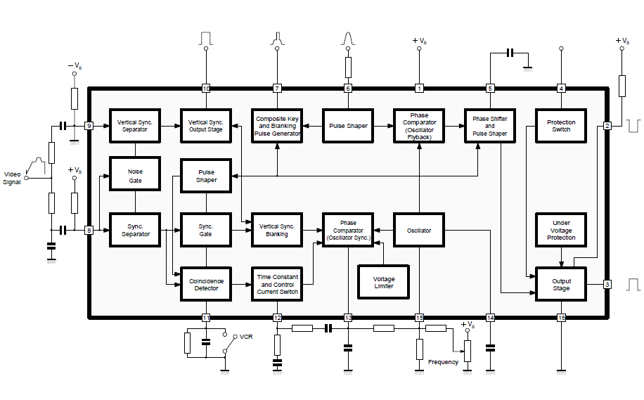

TDA4851's data sheet has more info.

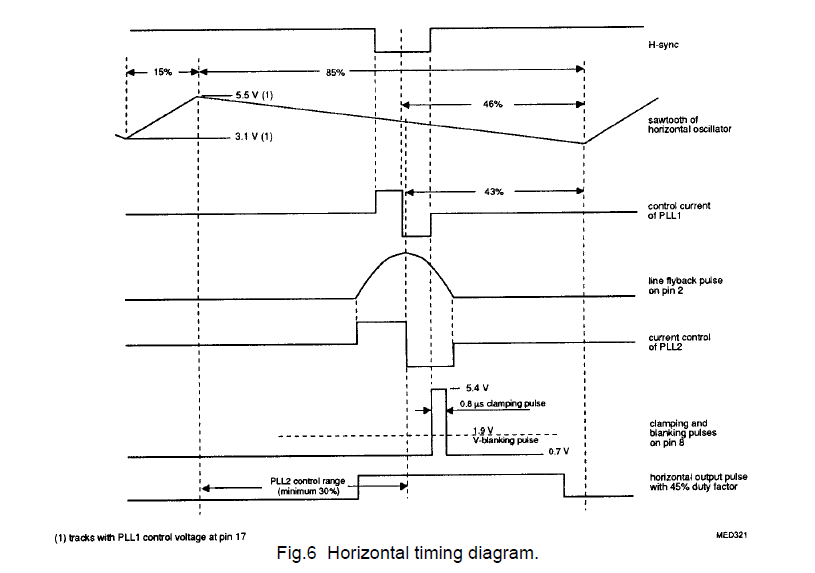

As I understand:
1) PLL1 keeps "middle" of sawtooth in sync with HSYNC signal.
2) PLL2 keeps flyback in sync with "middle" of sawtooth + applies flyback phase offset via delaying horizontal output pulse.
What is interesting here - flyback can actually begin BEFORE HSYNC's leading edge. I.e. it's not about syncing beginning of flyback with leading edge of HSYNC, as I expected. As flyback pulse has bell shape, it means syncing beam passing center of screen position during flyback with middle of sync pulse. I.e. at the end WIDTH OF SYNC PULSE MATTERS.
Errr. Still don't understand. According to description, these chips control flyback only. They generate flyback control pulses.
Pins 2 and 3 on this picture for example:
So, they don't output their oscillator's sawtooth. But how final sawtooth is generated then?
So, my current understanding of situation is following:
I'm not sure, if flyback duty factor should be standard or deviation is compensated by HPhase.
Oh! I'm stupid! Distance between "forward" and "backward" screen centers is always equal to 1/2 forward + 1/2 backward beam movement distance, i.e. it's always equal to 1/2 of cycle!
