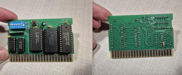

Just wanted to briefly revisit this old thread and confirm that yes, that
paper drawn scetch from Eudimorphodon is correct and working solution for the
3k ram expansion.
I drew it into eagle and mixed with another 32k ram ic to cover blocks 1,2,3 and 5
to get combined 35k of ram expansion. Added dip switches, so that the 3k expansion
or each 8k expansion can be individually switched on or off.
I've actually had the pcb for maybe a year and just never had time to complete it until now.
Seems to work great as "doom" is running and it does require 35k.
Pretty happy with it! And I do know that this can be accomplished much easier,
but it just gave me the most excitement to do it my way and learn along the way.
Also added reset switch to it to make it more useful.
Have a bunch of them 2k ram ic's too, which will come to a good use now...
