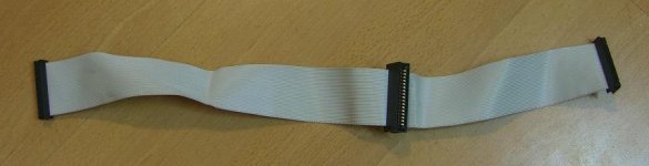

Now there does ring a bell... Some Tulip machines in those days didn't use the
cabletwist for the A-floppy. If you do, the machine thinks it's a B-drive.
Give it a test, use a straigth cable to the A-floppy drive.
Hmm dont have any single connector straight cables so I just tried connecting it to the "B-connector" of a multi drive flatcable but well still no go.
Any other idea's perhaps ?
This is my tulip AT compact 3, also an 286 computer.
As you can see there is no twist in the floppycable at all...
The Drives are jumpered to A and B

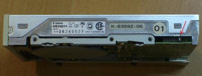

Maybe you can find some info about this canon drive.
This drive is set as A drive in this computer.
