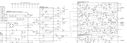

This is the schematic of the logic power supply regulator that creates +4.5V, -2V and +12V. I tried to annotate the schematic with info on what kind of transistor the HP house numbers corresponded to. In one case there simply were no match and I just wrote what it said: "SI AF Amp NPN". Basically a low frequency silicon NPN medium power transistor, I think.
Any opinions of what strategy to choose? Exact replica or redesign with new components?
I'm relatively pragmatic when approaching questions like this. Is the original design unique or ground-breaking in some manner that makes it worthy of exact replication ( are you expecting to show off the equipement by opening it up and pointing to the high-quality replica)? Can a functional replacement be designed that meets the same physical constraints and electrical/electronic requirements? Could the functional replacement include useful enhancements that aren't entirely inconsistent with the original design (e.g., crowbar)? Can the redesign be easily swapped out should the original implementation later become available?
In this case I don't think that the original design is especially "noteworthy" compared to the digital aspects of the HP2116; the power supply is simply a necessary precondition to a functional system. Substituting a regulator design with more capable components less likely to fail (and probably with a greater safety factor) than the original design & components seems like a good insurance policy against power-induced damage elsewhere in the system. That it would be a simple board-swap should an original regulator board appear is definitely nice.
I'd redesign the regulators (undoubtedly less well than you :-}), replacing as much of the original circuit design as desirable and retaining original circuitry where it's already "safe and effective" (and the parts are still reasonably readily available).

I have been thinking a bit more about this. Recreating an exact replica has the problem of sourcing exact the same components. Sometime I need live with the fact that I have to choose something close enough. For example certain values for zener diodes might not be readily available. Creating a functional replica with modern components adds the complexity that I need to FULLY understand the current design in ALL details so that I can recreate it with modern parts. Now this is analogue stuff and even though I know bits and pieces of analogue design I am nowhere that skilled that I could say that I fully understand the current design. For example it has a capacitor and resistor in series between base and collector in every regulator. Apparently this give some negative feedback from the collector into the base which increases with the frequency. So a low pass design if I understand it correctly (yes, I had to ask ChatGPT). There are a lot of those small details that will force me to simulate the full design in Spice to understand it.
Given I think that making an as exact replica as possible of the regulator board would be the easiest way forward. Then it is just the money and hassle of sourcing the right components.
The other option is to replaced the entire PSU with a set of Meanwell switchers but I don't like the idea very much. Don't throw away something that is not broken.

If you were to do a slight redesign using "modern" silicon semiconductors I'd gladly take a look and maybe come up with suggestions. From what I see on the schematic you posted it seems to be linear regulation? If so it should be easy to follow the circuit.
In general anything between base and collector are as you already found out a local negative feedback, It's in general only used with capacitors, as the more common flat frequency (or even only at DC and lower frequencies) way of having local negative feedback is a resistor in series with the emitter.
If we count max current consumption at the correct output voltage as a resistive load, then smoothing capacitors across the outputs in combination with the resistance of the load should roughly estimate at what max frequency the regulation need to work up to.
For power supplies that aren't lab supplies or for other special usage it's usually way easier to have a large enough smoothing capacitor on the output and make the regulation relatively slow, to avoid the risk of oscillation. (Somewhat related anecdote tangent: Back in the 80's, when I still was in primary school, I made an attempt at building my own lab power supply (IIRC using a TL084 OP amp) and I didn't know anything about frequency response and whatnot. At the first test it oscillated so badly that I could hear the oscillating as a sound emitting from the wiring or whatnot 😁 :eek: ).
Btw for the germanium transistors for the current sense circuits it seems like a good idea to use OP amps (that can withstand any theoretically possible over voltage) with some simple reference voltage (I.E. voltage drop over a regular diode + voltage divider or whatnot) for each of the current sense circuits. If you want it to look "cool old electronics" style, you could use round metal can silicon OP amps.
This is the part of the PSU that do the logic voltage. The transformer is not seen as the crowbars and sense resistors which are on another page. Below this part is the memory supply.
If you come up with a design that is handling all these voltage and does it with the same functionality in terms of sequencing the outputs when power it up I am all for it.
As you can see the PSU is actually a -6.5V supply and a -4.5V volt supply which in sort of grounded in the positive output.
I think reading up in the manual is also good to understand all the sequencing. http://bitsavers.informatik.uni-stu...tallation_and_Maintenance_Volume_2_197010.pdf
