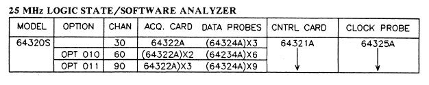

Thank you for checking. I hadn't realized that the HP 64000 was more than just a platform hosting a multitude of microprocessor-specific modules for in-system processor emulation/analysis (ICE):
It seems to be configurable as a general logic analyzer if one adds the more generic modules (e.g., acquisition, timing analyzer, state analyzer, control, clock probe, ...). For example:
From: http://bitsavers.informatik.uni-stu...DS_Configuration_Guide_5953-xxxx-Jul-1985.pdf
See pages 4-12 thru 4-16 there for the card configuration of the HP 64276 Microprogram Development System; Figure 1 in my earlier post now makes more sense. It's interesting that HP supported both a standard WCS configuration based on widths of 16, 32, or 64-bits for a maximum of (respectively) 16, 8, and 4-kWords, and a user-defined WCS that I infer was intended for supporting other bit-widths and capacities.
