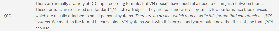

But they have this "stern" note about QIC:
