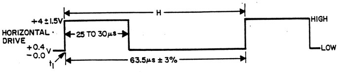

- I don't have a lot of experience with video signals but the sync outputs look suspicious to me (in general I see a waveform but nothing that seems like a well organized sync pulse).

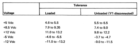

- On the A1 board pins I see +5V but it seems a bit low to me at around 4.6. +12V reads around +13V (like the CRT connector). All the front switch pins seem to behave themselves.
