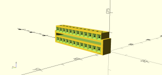

The prototype 3D shells printed by SLS (Selective Laser Sintering) just arrived.
They look very nice, the keying is perfect, they fit right onto the A1 board sockets on the inside of the cage as well as the IO cable sockets :)
But the plastic tang doesn't retain the DuPont contacts, they slide in fine but slide right back out too :(
So I went back to my junk box & found a different 0.1" square pin socket, TE AMPMODU IV/V:
Note the little metal tank sticking out near the front - we just need a hole for the retention tang. Simple fix, ordered couple more.
Anyway, if your friend printed a sample, I'd be interested in how it came out - what sort of plastic & process?
I just got them 10 minutes ago! Yes they fit perfectly and I was about to ask what kind of pins to put in there. I'll look at your datasheet.
Plastic used was PLA using a 3D printer (Ender 3 Pro)
However I'm not sure this could work for cards. Can you give me an example how I could solder to the ram card for example?
For power plug it's perfect.
Thanks!

Oh, it looks like you are using real original IBM shells & contacts? Maybe from a donor card & you carefully soldered on each contact?
Agree it isn't obvious how to use with a PCB. I have been thinking of a thinner version, where the crimp pins can hang out the back of the shell and be bent down to solder onto pads on the PCB. A tab on the edge of the PCB slides into a slot on the shell so it can't move sideways. The shell could be glued to the card. Then just push 24 sockets in from the back, bend each to touch PCB, solder, and done - the shell holds the sockets in place so easy soldering. A couple prototypes should show up by Monday or so. I tried to make them fit the TE AMPMODU IV pins.
Would it be worth reconsidering then some elements of my approach? Integration with a PCB at a right angle is intrinsic to my design; you get it "for free". Mechanical and electrical connections are accomplished with solder. With 24 individual solder joints, it's a pretty sturdy assembly.
I propose a combination: my approach of T-joined soldered PCBs with a shell like yours (appropriately shortened in height). I think it could assemble quickly and easily, perhaps the fastest of any of the solutions we've considered so far. The only thing we would need to find is the actual metal wire-to-board contacts that go into your shell; if those don't exist, it won't work.
Here is the three-step assembly procedure:
Step 1: Mate the connector PCB to your main circuit board in the T-joint configuration shown in this picture. Solder it in place.
Step 2: Stuff a shell similar to what you've designed with appropriate wire-to-board metal contacts. Presumably there are pins or tabs that protrude from each contact out of the back of your shell that allow affixing the contact to the board.
Step 3: Push those pins or tabs (sticking out of your shell) into holes in the connector PCB that you mated in Step 1. Solder.
(Does this description make sense? It can be hard to know if it's easy to understand.)

Hi Stepleton,
Yes I see advantages of your design. I started down the road of crimp-to-wire female wire wrap post contacts as one goal was to make up a power supply interposer cable (to easily measure current for each voltage) but for sure crimp-to-wire isn't ideal for a board edge.
One issue with your PCB has is that the contacts stick out well past the PCB so maybe it doesn't align with the black plastic A1 surround.
Also the female 0.1" sockets I see used on things like Arduino boards are low quality, don't grab well at all.
Consider MillMax machined sockets, those are the really nice ones often seen as wire wrap DIP sockets. So I phoned up MillMax product support and described the problem and they suggested this as a possible solution:
It is a machined female spring contact to be press fit or soldered into a PCB. The male A1 pins go right through.
So your PCB but with holes for machined female sockets will have excellent retention, and now the PCB would be flush with the front of the contacts so it will sit down right into the black plastic frame on the A1.
Now we have exactly positioned 24 female contacts with excellent retention. No need for a 3D shroud.
Thanks for posting! I think your small PCB concept is better than a shroud for PCB :) and just use shroud for cables.
I'm glad if my approach has some useful elements! I am not 100% certain of how to use the sockets you've described --- is there a way you could show what you have in mind via a drawing?
Currently, when viewed from the side of the PCB with the connector facing down, my current connector uses something that looks like this (using some Unicode art --- I hope it's viewable):
 |_| |_|      |   |
  socket       plug
My guess is that with the contacts you've found, the resulting connectors will look like this (note that only the socket changes; the plug is unchanged):
  _ ‖ _         ‖
  socket       plug
If the retention is firm, that could work, but on the IBM 5100 (and probably 5110/5120) on connectors Y1, Y2, Y3, Y4 and Z1, Z2, Z3, Z4 (see top and bottom of this diagram), there is a retaining bracket that expects to press against the top of the connector shell, as seen in this photo. In Unicode art, that looks a bit like this when used with my current connector:
    ‖  ┏━━━ bracket
 |_| |_|
  socket
If the socket connector looks like what I've drawn in the second diagram, then the bracket will not have something to press against. Again, this could be just fine if the retention is still quite firm, but the bracket must not foul the sockets both for mechanical and electrical reasons (the bracket is metal).
For pluggable cards like the memory card under development, there is no retention bracket, so this approach is still well worth investigating regardless of this concern!
