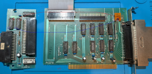

I see that you also posted on Vogons, at [here], and on a .de site at [here]. In post #7 of the .de site, you added photos.
Your 4965 is the type that expects power to be supplied to it via the cable that connects to the DB37 connector of a floppy controller. According to the thread at [here], "+12V goes to pin 1 and +5V to pin 4 of the DB37, ground on pins 2&3."
Good photos of the PY227B controller are at [here]. The user connects power to the orange connector, and that power gets routed to certain pins on the DB37 connector, per the photos below. A responder to the .de post indicates same; English translation: "The connection CNP of the card should include the power supply for the external drive."
Are you providing suitable power to the orange connector (CNP') ? Make sure that you do that correctly. For example, accidentally putting +12V onto the drive's +5V line might damage the drive.

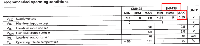

Could you just double-check that about the power supply voltages? I checked that, but if I were to connect the power supply as in your email (1 = 12V, 2/3 = GND, 4 = 5V), I am pretty sure I would break something unless I am overlooking something...
If I measure the setup, pin 1 of CNP1 comes out on pin 14 of the 2 ICs on the drive (the left PCB in the photo is the one where the round black cable connects). These are 2 SN7438 ICs, but those ICs are only rated for 5V and not 12V.
That is what I expect. See the diagram below. Note the crossover of pin numbering that is occurring within the PY227B.
