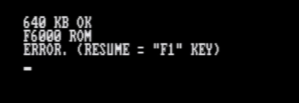

Attached is a screen capture of the error screen on POST....(see below)
At the moment I do not have any other 256K EPROM's (I have smaller and larger lol) but I will try to lift the pin 14 as suggested and see what happens.... its entirely possible that these 150ns speed TI chips were changed at some point - I have on order some ST 200ns 27C256's on the way.....
Also wanted to mention that I have successfully burned and used both the Ruud Test tools and the XT RAM test (see pic) without issue (they start right up) - the XT Tools are in a TI 256 chip and the Ruud is on a Winbond 512K....
Starting addresses of F8000 and FA000 makes sense. Per [here], those are the two 8 KB blocks in the low half (the problem half) of the U18 address space.
Just in case you are interested, the POST test that is producing those ROM errors is the 'ROM CHECKSUM TEST II' one in the 'BIOS Revision of 11/08/82' section of [here].

I pulled PIN 1 from both 27C256's in U18 and U19 - I got a different POST test result.....
Notice how its only reporting an error on one of the 2 ROM's - I did this test with my pre-programmed 11-02-82 BIOS images ....
F6000. Per [here], the last quarter of U19. The 8-bit checksum is not the 00 expected.
I also created another MYF800.BIN (it should be the zip file attached here)
That has a CRC32 of 79522C3D, which is a match for the 1981 copyrighted 1501512.

Well Sorry for the delay in the reply - the UV EEPROM Erasure required some "repairs" and I also obtained the W27E257 chips and I did program them each as a U18 and U19 with the May 86 Bios - All is well now with these EEPROM's - See Screen Shot -
Needless to say, Still not sure why the ST 256's were not working but if you want me to send you some of these chips to test with I'd be happy to do so.
M27C256, by 'ST Microelectronics'. At post #57, I found one. My (repeat: my) one worked. I didn't put it into an early 5160 motherboard; instead, verifying that all of it read successfully when pin 1 was grounded (per note 2 at the bottom of [here]).
