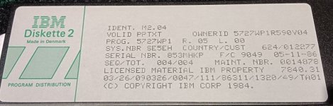

Have 2 boxes Written IBM S36, as seems to be from a S36 system.
All Original IBM Green label Disks
I have started to read them in.
Looking at Volumes couple er not complete sets, well could be some day show up some where.

These are in process:
Need to get Imd files from that old pc.
IBM36-24.IMD;
S/36 UTILITIES
VOLID; PPUTIL
PROG;5727UT1 R.04 L.00
F/C;9049 26-03-86
SEQ/TOT; 002/002
COPYRITE IBM CORP.1984
IBM36-25
IDENT. M1.02
VOLID; PPCOM
PROG; 5727SS1 R.05 L.00
SYS. NBR. SE5EH COUNTRY/CUST
SEQTOT. 001/002
COPYRIGHT IBM CORP.1983
IBM36-26
IDENT. M1.03
VOLID; PPCOM
SEQTOT. 002/002
IBM36-27
IDENT. M2.01
VOLID; PPTXT
PROG; 5727WP1 R.05 L.00
SEQTOT. 001/004
COPYRIGHT IBM CORP.1984
IBM36-28
IDENT. M2.02
VOLID; PPTXT
SEQTOT. 002/004
IBM36-29
IDENT. M2.03
VOLID; PPTXT
SEQTOT. 003/004
IBM36-30
IDENT. M2.04
VOLID; PPTXT
IBM System 36, 8 Inch disks 25-30
