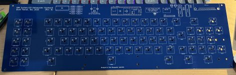

I've just ordered the keyboard PCBs (thanks to PCBWAY!), and I've also designed a simple DB25 breakout board for my logic analyser so I can see what the signals my Teensy is generating easily.
Keyboard PCBs have arrived. Need to order the Teensy 4.1's still (waiting for payday). And I need to figure out how to figure out the bus protocol.

So, ahem, I made a small design mistake ... the Teensy 4.1 is 3.3V logic and I designed for 5V logic (using a 74HCT245 and 74HCT125) so I've not proceeded with this PCB build so far.
This probably isn't an issue Teensy -> IBM but IBM -> Teensy is a problem.
But looking at it again ... maybe I can still re-use the design & PCB.
[1] Swap the 74HCT125 for a 74LVC125
[2] Pull up rows to 3.3V instead of 5V
I've also got some NOS Intel 8048s on their way (arriving next week actually) so another idea was to just re-use the existing firmware & Intel 8048, although not sure what changes would be needed as the original keyboard was capacitive?

It is, I need to get around to building the test keyboard. I had to design a SOIC-14-to-DIP-14 converter PCB, which I now have fabricated. So ... I have no excuses now to not build and test one out (although I don't have an actual System/23 to test with, but we'll figure that out ...)
The interface is pretty simple:
Use a 8255 PPI in mode 1 input or emulate it.

Oh, it doesn't look like 74LVC125 is available as a DIP-14 so I've whipped up a SOIC-14 to DIP-14 adaptor board so I can re-use the existing keyboard PCB.
You can take exactly the same approach for a microcontroller if you decide to try making a non-Teensy controller at some point. If your PCB design is double sided, you can sneak supporting passive components (SMD/SMT) onto the other side to save space.
If you really wanted to, you could even route all the connections to a single line of pins and mount the uC carrier to the mainboard without a DIP style socket/header.
If finding a DB-25 connector became difficult, you you could always use a keyed IDC connector. They are sufficiently snug, secure for this kind of usage.
