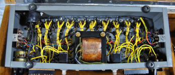

I can see the transformer for the tube heaters - but I can't see anything for the HT supply yet. I will have a more detailed look at the photographs and documentation on Monday. Too busy over the weekend...

I have been trying to work out the arrangement of the wiring.
I have come to the conclusion that the high voltage supply is produced outside of the module as shown and is cascaded between the left and right connectors via the red, orange, blue and black wires.
The 6.3V CT 10A transformer is clearly for the 10 off heaters for the valves fitted to the unit. However, this transformer will require an AC supply, and I suspect that is also provided via the same left/right connector.
