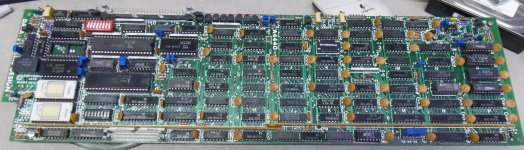

Not possible ? Yes, it is, if you have an older laptop with a real printerport, a DSD440 drive and a bit of TTL circuitry between the printerport and the DSD440.
While not yet ready for primetime, maybe someone may want to look if the following binary image makes sense ?
ftp://ftp.dreesen.ch/DSD/disk.img
( RX01, 77 tracks of 24 sectors of 128 bytes each )
As Al correctly said : it only works if you have a DSD440 drive. That handles the RX02 magic. My TTL interface is the basically a copy of the PDP8 /Omnibus to DSD440 interface, reduced to the max.
Modula 2 floppies are in excellent condition, that should not be no problerm. Still seem to have some unexplaind issues in my controller though...
Writing ? maybe, the interface should handle it, it should be a firmware issue only.

RX01 is 77 tracks of 26 sectors of 128 bytes for 256,256 bytes total
RX02 is 77 tracks of 26 sectors of 256 bytes for 512,512 bytes total
so you are missing two sectors per track it appears

OOps, you are right of course...
I corrected & updatet the binary dump on my FTP site.
If someone could check if that image makes sense ? It is a RX01 disk with a RM03 diagnostic program from DEC (DXDP+32)

ENTRY# FILNAM.EXT        DATE          LENGTH  START   VERSION
    1  HSAAA0.SYS    19-NOV-1979         24    000050
    2  HUDIA0.SYS    19-NOV-1979          6    000100
    3  HDDXA0.SYS    19-NOV-1979          3    000106
    4  HELP  .TXT    19-NOV-1979         26    000111
    5  HMDXA0.SYS    19-NOV-1979         17    000143
    6  ZRMAC0.BIC    19-NOV-1979         38    000164
    7  ZRMBB0.BIC    19-NOV-1979         49    000232
    8  ZRMCB2.BIC    19-NOV-1979         76    000313
    9  ZRMDC0.BIN    19-NOV-1979         72    000427
   10  ZRMEC0.BIC    19-NOV-1979         76    000537
FREE BLOCKS: 74
Seems to work reliably now.... Should I put in the extra effort for .IMD compatibility, or just keep straightbinary dumps ?
Interface schematic appended...
