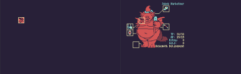

I'm currently writing a game in Turbo C using CGA graphics, and I've run into a really annoying problem with writing to the screen. I'm using a double buffer that I write to and then copy it to the screen to update it, but at my current skill level, I can't figure out how to only update the bits of the screen I've changed. I can do it in C, but then it's super slow and causes there to be giant holes in the screen where it isn't updated, and copying the entire buffer multiple times a second can't be right.
I'd like to implement some kind of dirty rectangle system, but I need some help modifying the asm that pushes the data to video ram.
Here's the current buffer copying code:

You have some bugs... you're not reloading cx in the loop ("rep movsw" will leave 0 in cx). And I don't think you want to add your offset to your es value. There may be others - I didn't try running it either.
I tried to fix the bugs, it just hangs the engine. I'm afraid I'm incredibly bad at assembler. I don't know what could be going wrong. I set the destination at 0b800h, then I add the offset into it, since I don't want to write pixels to 0,0. I set the source the same way, and add in the offset. Is movsw expecting something different, like for the offset to be in words? Is my math wrong?

I did it!!! I learnt a lot about assembler programming in the process. The reason for the hang is that using lds destroys all the local variables, so I dropped them entirely and just worked using registers. With some fiddling (and double, and triple checking my math), I managed to create a function that does what I want! I'll attach the code in case there's something I've missed, and an image of it working. I update only the area of the square, and on the right is the entire back buffer. I'm sure it could be sped up but it WORKS, and that's a big step.
I have read the black book before, it's a really good resource. It was one of the first things I read when I started programming!
