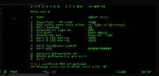

Following pics are from the unit, thats now on my work bench
Pic of the unit running. Taken in B/W for clarity.
