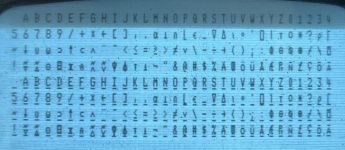

For reference here is the IBM 5100 character set - for what I meant about "the other half" just being underline versions of the top half. Perfect for when you need underline versions of Greek letters (I wonder if for purposes of variables, does phi equal underscore phi?).
The first row (below) is the first 32 characters, and so on. It's not EBCDIC at all on the 5100. Note the BASIC-only versions of the 5100/5110 share the same display card as the APL versions, so either can be used to type and show APL stuff.

Not knowing anything about the 5100 I would hazard a guess that the underlined set uses the same ROM glyphs as the non-underlined and the line is added in hardware. That’s how reverse video worked on the Commodore PET. (Later Commodore machines had the full 256 characters for both sets in ROM, but the PETs only had space for 128 and had bit 7 tied to inverter circuitry.)
FWIW, those semi graphic characters on the TRS-80 and other ancient relatives aren’t in ROM either, they use some clever logic circuitry to convert the bits into the sub-blocks directly.
The underscored alphabet is needed in APL for variable names. It does allow one to split the results of the )VARS command since it would sort the alphabetic characters before the numbers and the numbers before the underscored characters.
