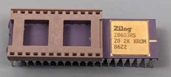

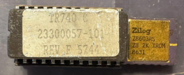

A few suppliers had chips like this.
I know the Zilog Z8 did...

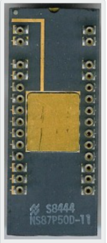

There's also some 8051 variants that do that. The purpose of such chips is to allow external code while still using all the pins for their original microcontroller purposes. I actually have an 8051 in-circuit emulator which uses one inside, with a ribbon cable to connect it to RAM.

Is this a better match?
The lower 24 pins are for the EPROM. The upper pins are for links to configure the device to emulate different variants of CPU within the family.
