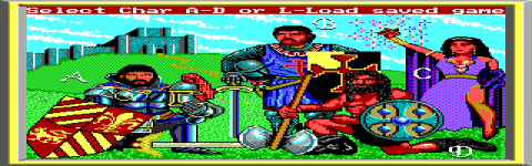

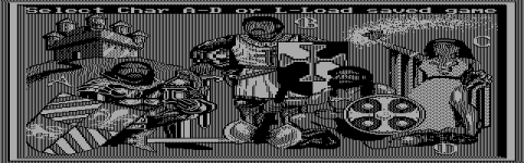

After several months of development, a compatibility package for various graphics cards is set to be released:
│    320x200    │ 640x200/400/480 │       720x348/350       │
│ M - MCGA      │ W - SVGA        │ I - Hercules color      │
│ V - VGA       │ X - XGA         │ H - Hercules monochrome │
│ E - EGA       │ 8 - IBM 8514/A  │ R - Orchid monochrome   │
│ C - CGA       │ G - PGC         │ 3 - 3270 PC             │
│ T - Tandy     │ S - Sigma       ├─────────────────────────┘
│ P - Colorplus │ A - PC1512      │
│ Q - Quadcolor │ D - DEB         │
│ B - GP II     │ O - Olivetti    │
└───────────────┤ Y - WY-700      │
                │ N - NGA         │
The remaining graphic modes generate images identical to the existing ones.
3-3270PC.png A-PC1512.png C-CGA.png E-EGA.png G-PGC.png H-Hercules.png O-Olivetti.png Q-Quadcolor.png S-Sigma.png V-VGA.png Y-WY-700.png
