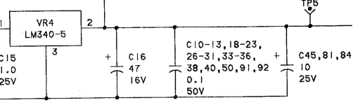

If the problem is with the monitor, measure the DC voltage rail after the voltage regulator on the monitor PCB, then look for fusible resistors that have gone open circuit.
Note that there are two (2) off +5V regulators. Are BOTH +5V regulators working?

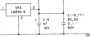

I'm getting 5v on c4, c6 & c9. Does that mean the VRs are ok?
Unfortunately not...
Assuming I have identified the same schematic as belonging to your specific machine, C4, C6, and C9 are off the output of VR3 (so you are still only measuring the output from one (1) voltage regulator.
Try across C10 - or one of its siblings...

C10 and C13 are at 5v.

The voltage regulators on the logic board seem OK then.
