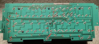

I got my order of a mixed batch of a few more of the Hi-Tek keyboards plus an equal number of "hacked" Stackpole keyboards. Note for anyone interested in this deal:
  • They aren't kidding about the Stackpole keyboards being hacked. It looks like it'll take about a dozen repairs to the PCB board to restore it to the original matrix.

... Probably should stop responding to this, but in the slight chance anyone cares, here's what you get if you get some of those "hacked" Stackpole keyboards:
The stackpole and hi-tek keyboards look almost alike; the Stackpoles are *slightly* lighter colored, and while both types have textured keytops the sides of the Stackpole keys are much shinier. Here's the two next to each other, Stackpole on top:
As I said, the plastic for the keys is much thicker. The stems are compatible enough to swap keys, but the angles of the stems are *slightly* different, so if you mix keycaps on a single board between this and the differences in shine it won't look quite right:
It looks like they cut the traces on the boards with a combination of a drill bit and a wheel cutter. Here's what one of the drill-bitty holes looks like, and it shows what I did to fix it; I sanded off the solder mask, blobbed some solder on the trace ends, and laid a single strand from some stranded wire across the gap.
Here's a shot of the whole back of the board after I fixed it and covered the patches with nail polish. The worst part to repair is under that blob in the upper middle of the board, there are four traces cut with a wheel cutter at an angle. All the boards I've looked at have exactly the same hacks.
And here's the whole mess hooked up to the test arduino scanner, showing all the keys work. I did discover a bug in my scanning software that causes you to get an extra press if you release a shift key before the key you're shifting. I've fixed it.
Anyway. If you're willing to spend about an hour bridging the cuts the keyboards are serviceable enough. Pretty good deal for $3 each, I guess.

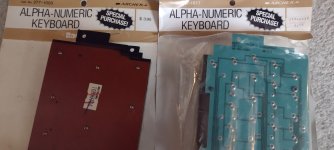

I got a tray of these. Cost per keyboard was a bit more than the old $3.95 archer/radio shack keyboards on closeout long ago, but reasonable for modern times.
The Stackpole keyboard trace cuts were the same as others here have observed. it looks like they were isolating control keys for whatever reason. Maybe a ZX81 upgrade? The cuts are highlighted here:
Correction, $2.95! I guess they had a closeout sale on the 277-1017 Stackpole variant and replaced it with the 277-1023 Mitsumi type. The older Stackpole model was the better deal but back then it probably looked dated and they couldn't get rid of them. I recall TI99 power supplies going for about the same price. It was junk unwanted surplus.
