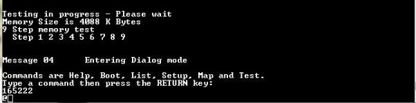

Well, after months of waiting I finally booted my pdp11!!!
It started life at an 11/23A. I pulled all the boards put in a new back plane (H9276-A). Found a H7861 power supply and replaced all the caps. I even stripped and repainted the front panel. The panel was in rather poor condition. My processor is a M8190-AE KDJ11-BF and the memory Clearpoint DCME/Q4E, 4Meg Memory. (PMI) Last week a found a FPA to plug in.
I was going to power the box up last night but discovered that the serial connector was broken and had to replace the header. I can't imagine how much force it took to break through all the even pins... IN any case nothing else was damaged.
I never could find the documentation to the DCME card. But from what I can tell mine is the only one I've seen on Ebay with the jumpers in for it to work in the PMI mode.
So being a TOTAL PDP novice, what next? RTFM I suppose. When I try and enter anything on the serial console I just get at signs in return... '@'. How to I get to the point where I can run diagnostics? The memory appears to test ok, I think...

I got the console communications working both directions now so that whe I hit a key it show on the terminal. I had send on pin 8 and ground pin 7.
