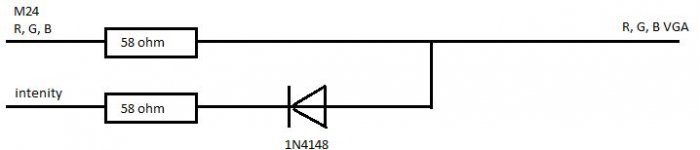

I don't work well with verbal descriptions--how about a schematic? You might also look to see what the IBM 5153 CGA monitor does, since it has to deal with the same issue.
Here it is:
"C" stands for any of the colour lines output by the 6300/M24 (R, G, or B). If we call V_H the voltage at C_OUT when intensity is high (ie, on) and V_L the voltage at C_OUT when intensity is low (ie, off), then with the circuit above we have V_H / V_L = 1 + R1/R2. Let's say we want V_H to be twice V_L, so this would mean R1=R2 (let's call this common value just "R"). In this simplified case, V_H = V_ref * R3 / (0.5*R + R3), where V_ref is the voltage corresponding to logic 1 (let's say 5V).
Then let's say we want V_H = V_ref / n (ie we want V_H n times smaller than V_ref) then this means R3 must be equal to R / (2*(n - 1)).
We have one more free variable - R itself - which I guess we could set by trying to maximise the 'HCT08 switch speed (there's something in the datasheet about optimal load) or by aiming for the VGA-standard output impedance (? 75 Ohm - not sure this makes sense here).
All of this if I did not make any mistake in my math! :)
Maybe, but I wonder about the combination of resistance+output capacitance of the HCT device.
Maybe the more "brain dead" approach might be to use a cheap video DAC, such as the ADV7120, which would allow "tuning" of each color. You might even be able to work out a good scheme for "brown" (low intensity yellow).

Thanks - I had a look, looks like the ADV7120 needs a pixel clock input, which is not available on the external connector (unsurprisingly). Unfortunately it's not even present on the expansion board connector on the video card :(
Anyway HCT08s are cheap - I might give it a try next time I place a Mouser order...

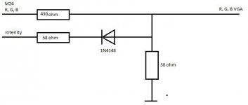

Right, I forgot. But with little modification it should work. Increase just the upper resistor value and add another 58 ohm to ground. The upper resistor and the new resistor behave as a voltage divisor. 5V should be 0,7V at the output. So you need a voltage divisor with the factor 7.14 (5V/0,7V=7,14). 58*7,14=430 ohm (not really, exactly it is 414 ohm, but 430 is closest availabe)
Intensity is at high level: R, G, B is not influenced by the diode, so full TTL level goes through 1:7,14 voltage divisor to about 0,7V VGA. Red is red. Green is green, Blue is blue.
Intensity is at low level: The diode pulls R, G, B towards 0V over the 58 ohm resistor. This 58 ohm is now (as intensity is on low (ground) level parallel to the other 58 ohm which is permanently on ground. two parallel resistors: 58²/(58+58 )=29 ohm, in total half the value of one 58 ohm resistor. That means the voltage divisor is now 1:14,28, that means (without the diode) R, G, B output is maximumm 0,35V on 5V TT. But as there is the silizium diode which has a breakthrough voltage of 0,6V, the R, G, B voltage is somewhere at 0,45...0,6V (I would need spice simulator to see exact behaviour). That is lower than 0,7V and the monitor should display a darker color. As this should be the vice versa of the intensity signal meaning, we need an inverter for the intensity signal. Or double the 430 ohm and reverse the direction of the diode.
That's beginning to get at what I meant by "more complicated". The output of RGBI is LSTTL, so it's not nearly rail-to-rail. which is why I suggested some CMOS or at least a JFET switch.
For me, the simplest would be a switchable high rail between 0.7 and 0.4 (for example) V, driven by a MOSFET switch off the I pin. The RGB outputs would probably drive either CMOS or JFET switches from that. Doubtless there's a video mixer/selector IC out there that could pretty much do the job.
(I like JFET in this application as they conduct at 0V--you turn them "off" by applying a suitable "pinchoff" voltage. That's another reason you see them used in video work).

This wouldn't get yellow correct, however (see previous discussion on how the monitors intentionally display yellow as dark brown).
