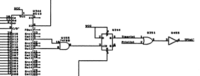

Fixed the millisecond alarm emulation in MAME so ESetAlarm() / signal(SIGMILLI, ...) now work. It works by using the timer 1&2 output pins to latch the interrupt and then have addresses 0x100 above this reset the interrupt. This IRQ (IRQ1) is shared with the printer but I've ignored that for now.

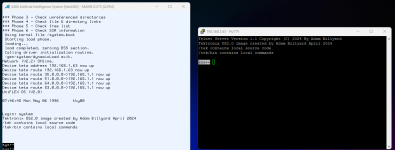

Hello,
Awesome work with the emulator! I'm trying to install UniFLEX myself. I created a 40Mb chd with "chdman createhd --chs 830,6,17 -o disk0.chd" (although I would prefer to create the 90Mb disk in the brochures, I haven't been able to find the exact disk model for it so I don't know the CHS value), booted from the OS 2.0 SYSREFORMAT disk but after a minute or so I'm met with a blank cursor and no activity. Is this normal? (For reference, I've built mame from the tek4404_working2 branch)
Hello,
No, it should boot.
If you start mame with -debug it will have the mame debugger window visible. This allows you to press F3 to emulate pressing the reset button. Pressing F3 twice will bring up the diagnostic program that allows testing various things. Have you all the roms you need?
Let me bundle together a folder with mame 4404 emu + all the files you need for a known good setup and see how you get on.
Adam
From the self-tests, Interval Timer (spams the screen with errors), Virtual Memory, Mouse Interface seem to fail. Others are OK.
Oh, and also to note, I am on an Apple silicon Mac.
OK, here you go. Download this into your MAME build folder and unpack it.
It will add neccessary roms and a couple of launch scripts to your mame folder:
mac4404.sh
win4404.bat
as well as macmame and winmame which are builds of MAME with just the Tektronix drivers (ie much smaller than the fullfat version).
At the command line, you should be able to run the appropriate one to boot Tektronix 4404 and get to the login prompt.
