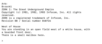

Introducing the MicroCore Labs MCL8080+
The MCL8080+ is an Intel 8080 emulator written in C which runs on the ATTiny85 microcontroller. Instead of the 40-pin package that Intel used the MCL8080+ local bus is implemented with a SPI serial bus with a number of optimizations!
The complete 8080 emulation and local bus are implemented in the ATTiny85 microcontroller and all of the system RAM, ROM, peripherals, and disk images are provided by a Teensy 4.0. Some resistor voltage dividers are used to convert the ATTiny85’s 5V IO’s to 3.3V for the Teensy 4.0.
The ATTiny85 is a very resource-limited microcontroller which has only 512 bytes of RAM, 8K of ROM, five GPIOs plus minimal serial bus support. The MCL8080+ 8080 emulation code was developed to save enough space to allow for a small 128-byte direct-mapped cache that greatly improved the performance by reducing activity over the SPI bus where all of the program code and data resides.
Due to these optimizations the MCL8080+ boots CP/M just a hint slower than a genuine Altair 8800.
The MCL8080+ is written in simplified C using a lot of inline code and minimal calls and returns to reduce space and execution time. The emulator passed all 8080 opcode tests including ZEXALL:
The MCL8080+ local bus is implemented using a custom SPI bus which is optimized to improve efficiency and speed. All accesses are performed in burst cycles with auto-incrementing addresses until there is an address change. The SPI chip select was converted to a toggle to indicate that there was a new address on the bus which saves the MCL8080+ from having to toggle it at the end of SPI cycles.
The SPI slave controller is supported by a Teensy 4.0 which implements a bit-banged custom SPI controller and provides 64KB of RAM, the floppy ROM bootloader, a UART interface, a floppy controller, multiple BASIC, ROM, and floppy disk images including CP/M.
Running all system RAM, ROM and peripherals over a serial bus would normally make the system too slow to be practical. The MCL8080+ achieves a massive speed improvement by using a 128-byte direct-mapped cache which eliminates unnecessary SPI bus reads for code loops and frequently used code.
The MCL8080+ can run the original Altair 8080 BASIC famously written by Bill Gates and friends.
And when running the Altair floppy bootloader ROM the MCL8080+ can access two emulated floppy drives to run CP/M, MBASIC, and a number of applications and games.

Funny that the magazine cover is getting more interest than the project :) I thought this would be an amusing addition since the Intel 8080 was an Altair-era CPU and the MCL8080+ can run Altair software. I felt that the people in the know would recognize that magazine cover...
The goal of the project was to see if an 8080 emulator would fit (and run fast enough to be usable) in such a weak microcontroller with a serial SPI bus interface. Someone tried this already with an ATMega328 (with a CPU more powerful than the ATTiny85 that I used) and got results that were too slow to be usable. My approach was to target the smallest microcontroller, streamline my emulator code, add a cache, and streamline the SPI bus controller.
