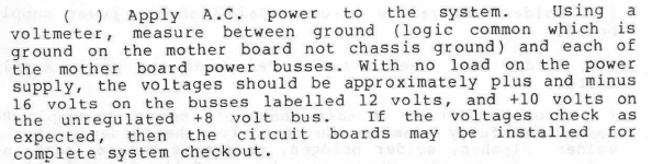

I put it all back together and put it outside on the drive. I powered on the psu with a bare backboard no cards, nothing.
8V line reads 9.2V (a bit high)
12V line reads 16.25V and
-12V reads -16.25V
All seems a little bit high to me, is that just because there is no load ?
Any suggestions how to load a S-50 bus ? Junk hard disk or cdrom …ECD901B4-B2CB-4EC0-84F9-A1E6BF39FE7F.jpegB911AA70-1F29-484D-B7C0-EB9BE26A0942.jpeg
These aren't regulated voltages, so they will be a bit high...
The Voltage regulators should be on the cards themselves (if memory serves me correctly).
Use car lamps (in series if necessary to match the supply voltage) and of the appropriate wattage to apply a suitable load to the supply.

I found the power supply manual, expected is approximately 16V on busses labeled 12V !!! and 10V on the 8V buss.
Attached here is a scan of the Midwest Scientific Instruments Power supply PS-1 and SI-1 serial card documentation.
I couldn't find it anywhere else. I'll put it up on archive.org.
