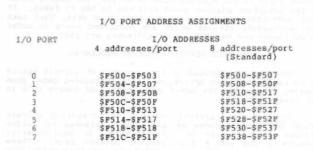

That means the SS-50 bus address lines are now SS-50c, and the io space is moved from 8000h to E000h (?), I think 16 addresses per port, i.e port 0. = E000 - E00F, port 1= E010 - E01F, etc.
My hope is you can find some reference to a port range for where the floppy controller card should be, randomly swopping card positions has not worked so far…

As regards the previous discussion of "IO Address space - 8000, E000, etc, I found an article in Kilobaud that describes moving the IO up to address F800 to leave more lower ram/rom free (Peter Stark, 1980, May).
The Midwest Scientific Instruments IO is up in the F500 area, but my board has some bodge wires in the address decoding logic, possibly to give 16 addresses per port and IO in the F800 range.

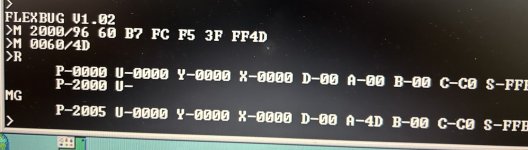

I think I found the i/o !
So if I load A with a value (4D=M) from memory 0060h and store A into the ACIA 6850 living at FCF5 - then the ACIA outputs a letter M to the terminal.
I put the code at 2000, and set the program counter P to point at my “program”
Ld A #0060h
STA FCF5
SWI
typing G [return]
Gives me a “M” at the start of the line !
So since the serial card is at port 6 this would allow me to work out the address for the floppy controller in port 0. If I knew number of bytes per port 4,8 or 16 ….
