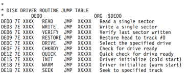

Then it's back to trying to get TSC FLEX/09 up and running on the MSI6800/GIMIX6809 system.
1, ultimate goal - boot Flex/09 from 8" floppy disk and have both 8" drives working.
2, intermediate step - setup the floppy controller to use a 5.25" drive to boot any flex disk to prove the floppy disk controller can read disks, or boot from a GOTEK 5.25" floppy emulator with flex format *.DSK images on the USB stick. The Flex user group site has a lot of *.dsk files.

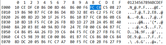

It looks like we have a bootstrap loader at the beginning of the monitor "BOOT" at E000, probably called by the "FLEX" command. This makes both the 8" disks spin - presumably looking for a boot sector #1, track #0 on the drive. The bootstrap should load into C000 then execute there ?
and look at this below ! lots of FCC0 and C000 (notepad is FLEXBUG)
I think you already disasembled this. I need to look back through the "reading 2716" roms thread.
