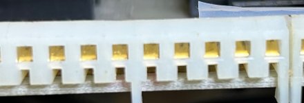

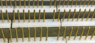

Some pictures of the pins
They are golden in color, but definitely brass underneath. Perhaps some evidence of gold plating at the root of the pins where its a lighter yellow.

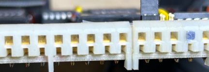

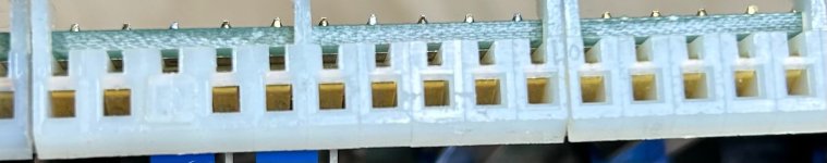

Good photos of the pins, thanks. Can you photograph the sockets on the SS-50 cards? Show any wear?
The thing is, many people report that TNIG gold on copper (nickel layer) will wear quickly and in the long term will corrode through. This is gold on brass/bronze, may be thick/hard or thin/soft gold. There's still old-stock Molex gold/brass parts out there, I'd like to know if they are worth the effort to obtain. But in your case they would be replacement parts! - regards Herb
You can see some darker paches further into the connector, possibly some gold flake bits. But after 40 years they still look ok.

Enhanced closeups of your photos, show the features you describe. Seems to me the pins have sharp points, poorly cut rather than blunted. Those could act as scrapers deeper into the connectors, where the point of the pin makes forceful contact against the spring of the connector. Meanwhile, repeated removal on the SS-50 connector at the front of the bus, seems to have worn down the finish on the pins as in photo 4925. There's also evidence of small flakes which could be scraped gold. These photos and your descriptions are very informative, thank you! - regards Herb
