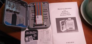

Came with book and 2 small cards. No marks of any form in the book.
Really does not look like its ever been used.
Had the 5 genuine jumper leads still inside.

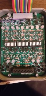

yes you guessed it. I decided to unscrew cover. So here are 2 pics of whats inside.
What I find slightly strange is there is no switch for the Power to turn off the batteries when not in use. Manual makes no mention of this point.
I assume one simply unplugs the batteries when it not being used. OR it has a SMART circuit consumes no power when its not connected into an active RS232 Circuit, but is activated when connected to live RS232 cables etc
Also I tried brand New VARTA Brand Longlife AA batteries and it appears they are slightly larger than the AA available when this was made. both in diameter , length and diameter of the positive terminal.
They are a tight fit end to end and side to side.

I wrote the above comment latish last night after a long day and 2 strong pain killers for arthritis in the thumb joint of my Dominant right hand. About 4am after a 'mother nature call', I picked up manual as I hopped back into bed, as it was bugging me that lack of power switch comment I had made earlier in this thread. I was sure it was just me having a 'Dumb old male' moment.
Yep there in the Manual was the simple circuit for 1 signal line, repeated for all 13 Led's.
Thankfully I don't live in a Brick house as a 'pile of them hit me' looking at that basic circuit.
When the unit is not connected to a circuit there is NO signal to 'drive' the Base of the Transistor. Therefore no current flows though it to power the Led.
Manual mentions Battery Life at 40hrs, which I assume to mean 'operational' hours

Well there will be thermally-induced C-E leakage currents in both transistors in the low uA range (well below the LED threshold) That will still add up over time and deplete the batteries. Of course the batteries will self-discharge ("shelf life") as well.
