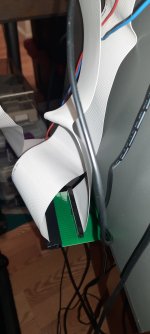

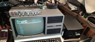

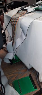

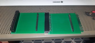

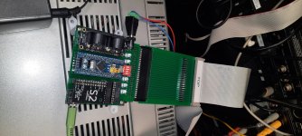

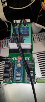

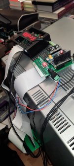

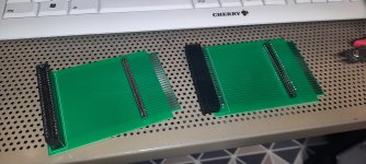

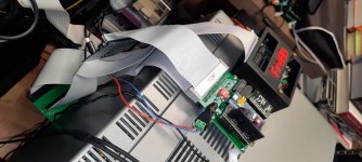

Simple passive port extender for the Model III / 4 to help with "expansion port hogs" such as the FreHD. Gerbers attached. Joint work with @mloewen
There are two versions that differ for the pin header layout: odd-even and even-odd. Be sure to select the right one for your needs.
