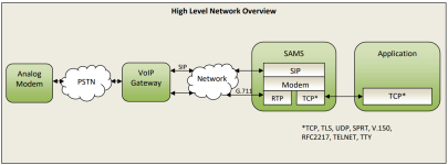

Third (my favorite) cloud based modems where VoIP calls are answered by DSP routines. Where one physical modem is used by the caller over VoIP.
vocal.com/voip/moip/ (MoIP and SAMS) Very pricey because $17k for license for 32 modem pool.
I have a few old school physical modems myself using G.711 codec on a Grandstream ATA.
(image from vocal.com)
