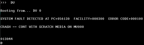

Hi,
finally I got into the mood to start developing an MSCP card for the Q-BUS64 of my PDP-11/Hack. The hardware is pretty similar to my RLV12 emulators, which als exists as a real Q-BUS version as well. Which means it is an MSCP Controller with diskimages stored on a SD-Card either as partitions of a MBR formatted SD-Card or as disk image files in a FAT-32 formatted partition on the SD-Card (both are possible at the same time)
So far the hardware seems solid and the firmware is at a stage, where I can boot RT-11 from the MSCP controller, create copies of the disks, create new boot disks, etc.
However when I try to boot RSX-11M+ the boot process ends with the following message
        SAV -- Booted device cannot be brought online
131626
Obviously something goes wrong. I started to compare the boot process of my MSCP controller with the boot process, using the same disk image, in SIMH. I started with debugging output on the rq0: controller, but in fact I would need much more detailed information on what is going on to be able to compare, preferably a SIMH debugging output which dumps the MSCP messages and responses or at least the responses. But my C-Coding skills are near non-existant and I have no clue how I would do that in the pdp11_rq.c. So my question is if someone would be willing to help me to add such a debugging output, or knows if there exists a possibility in simh to get more output then just the debugging output .
I'm using the disk image which was previously here ftp://ftp.trailing-edge.com/pub/rsxdists/rsx11mplus_4_6_bl87.dsk
Perhaps it is important to note, that when I boot RSX-11M+ from my RLV12 emulator I can access the diskimage

Yes indeed the image disappeared and I just used to have a copy, I was searching but couldn't find it again. I do also have the documents you attached and even some more, but they don't give any hints to what could have gone wrong. I have gone through them already several times. The issue is that RSX expects some specific values for an RD54 being returned by the ONLINE and GET UNIT STATUS responses, but I could not figure out which values, as the documents do not go into such detail as disk type specific values, only generic hints. I thought I could figure it out reading the pdp11_rq.c source code of simh, but as mentioned my C programming skills are not sufficient to figure this out from the code alone.

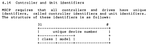

The SIMH code is hard going... If it works booted from RL02, it seems unlikely that would be the issue when booting directly - you are returning the same data I presume.
I implemented it returning a drive type of RA81, as that is often used by third party controllers - but have only used with RT-11 and TSX. It's likely a different order of ONLINE and SET_CTRL_CHARACTERISTICS commands
Can you upload / share the MSCP boot image somewhere?
Robin
What data are you returning for set controller characteristics words 11 - 13 and online words 14/15 and 18/19?
Hmm - not sure what hardware config that image requires - it is not happy with my fast 11/23 emulation:
Does it need an I&D space CPU?
Robin
I suppose that when you say, you try to boot RSX11-M-PLUS from that image file, you use the hardware bootstrap to load up the boot sector (LBN0) of that image and jump to it?
Meaning, you use the so called "saved system" bootup, in terms of RSX. The saved system is loaded by the SAV task (which is used to actually save the system after it was generated and brought up in memory for the first time -- that process usually includes writing the boot sector of the disk, with the /WB switch), and that assumes the saved system matches exactly the hardware you have. And that's where (most likely) SAV encounters the discrepancies and aborts the process.
Another way of bringing up the system is to try to boot it in a soft way from a file. Once booted from RL, locate your system image on the DU0: drive and try booting up the system with the BOO command using that file. The image that the boot sector boots from that drive is this:
RSX11M.SYS;1        (4315,6)       1026./1026.     C  03-NOV-1999 18:01:52 [1,54]   [RWED,RWED,RWE,R]

The Image requires I/D space and at least 1Mbyte of RAM, in simh I always use "set cpu 11/93 4m" which is the equivalent of of the new CPU card of my PDP-11/Hack, for online I return
0x00 0x00
0x02 0x00
0xD0 0x26
0x00 0x00
0x00 0x00
0x89 0x00 <-opcode "online" | op_end
0x00 0x00
0x00 0x00
0x00 0x00
0x00 0x00
0x00 0x00
0x00 0x00
0x00 0x00
0x00 0x00
0x06 0x02
0x33 0x40
0x64 0x25
0x00 0x00
0x00 0x00
0xEC 0xC3
0x04 0x00
0x00 0x00
0x02 0x6F
and for SCC
I return Software Version 2 and Hardware Version 1
As for the image, yes it is a standard disk image with /WB written back. It boots perfectly in SIMH. As for the hardware, RSX-11M+ is not very picky, in this case it just requires the MSCP controller, the console a processor with I/D space and at least 1Mbyte of RAM. It will automatically bring all devices missing offline.
good hint about the using the boot command from the RSX-11M+ bootet from RL I'll try that.
>mou du:/ovr
>boot du:[1,54]RSX11M.SYS
131626
Definitely something I respond wrong in my MSCP Server, I managed to produce some trace in simh (some crude hack with my little C knowledge) to trace all MSCP response packets and what I see is rather strange in the online command
DBG(5853)> RQ REQ: cmd=0009(ONL), mod=0000, unit=0, bc=00000000, ma=00000000, lbn=00000000
DBG(5853)> RQ TRACE: rq_mscp - Queue

OK - weirdly, I have the class and model in upper and lower words - not the bytes as per the diagram - and mine fails to boot if I change it as per diagram...
I think the device number should be unique amongst all controllers and disks as well - I use the top byte as a prefix, like 1 for controller, 2 for disk - and the controller or disk number in the lower byte
I tried it both ways now (by accident) and no change. They failed both. But in the meantime I managed to get better idea about the debugging in simh and added my own MSCP response message trace. I will now compare the two trace outputs, i.e. mine and the one from simh. But this will have to wait until sunday.
Thanks for the document, that explains and defines many of the bits and bytes I didn't find in the other MSCP documents I have. I added all the flags and version and IDs I previously just zeroized according to the document and the trace from simh and just in case made also sure other things are reported exactly the same as I can see in the simh trace, although in my opinion the disk reported by simh is not RD54 but the next in the table which is RA60, but RSX-11M+ seems not to be bothered by this. Nevertheless, RSX-11M+ is still not happy with my version.

@165600g
RSX-11M-PLUS V4.6  BL87   1024.KW  System:"RSXMPL"
>RED DU:=SY:
>RED DU:=LB:
>RED DU:=SP:
>MOU DU0:"RSX11MPBL87"
>@DU:[1,2]STARTUP
>;                      PLEASE NOTE
>;      If you have not yet read the system release notes, please do so
>;      now before attempting to perform a SYSGEN or to utilize the new
>;      features of this system.
SYSTEM FAULT DETECTED AT PC=056130  FACILITY=000300  ERROR CODE=000100
CRASH -- CONT WITH SCRATCH MEDIA ON MU000
013044
one step forward
Just as info, at ROM location 165600 I have my MSCP bootstrap loader
And after some thought, the crash could be as well caused by the fact that my CPU card reports the module ID of a KDJ11-E but does not implement all registers. Or other devices configured in this RSX-11M1 image that conflict with may hardware. Perhaps I make now may on SYSGEN for a DU: disk image with only the things my hardware really has.
although loading of the RSX11M.SYS image seems to work
It certainly did work, because it was already SAV that was working trying to restart the (loaded) system from its hibernate state.
The error was posted by the SDISK routine, the source code of which you can see on that very same DU disk in [12,10]SAVE.MAC
