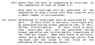

Another possible gotcha is that the IE bit is only for initialisation interrupts - the presence of a non-0 vector enables interrupts during normal operation, as well as the "F" bit...

There are a lot of strange oddities regarding interrupts. And in contrast to the note regarding the interrupt after step 4, the RQDX3 controller does however generate an interrupt after step 4, and the RQDX3 source code shows this as well. In my case RT-11 never boots if I did not generate an interrupt after step 4, however that was the case before I did all the changes and corrections for RSX-11M+ to boot correctly. I will test this again later with no interrupts after step 4, but at the moment, interrupts after step 4 do no harm neither to RT-11 nor RSX-11M+. What I see regarding IE is that when an RT-11 or RSX-11M+ reinitialise the controller, which they have to do because the ring configuration of the boot stage differs from the ring configuration of normal OS operation, they always set the IE, I assume they expect interrupts for the initialisation steps in order to not have to poll the device during initialisation, as the OS is already executing and it would be annoying in case you did not boot from DU: and when activating DU: you would wait polling the MSCP controller to get online. So a non-zero vector with IE not set is a very useful scenario.
