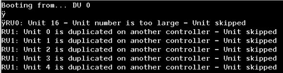

Gave it a try. But no success. It does something but after some time the only thing RSTS does is a Get Unit Status and a Set Controller Characteristics. Looking at the INI file this seems to be configured for a Unibus machine. Should it as well boot on a 11/73 CPU? Unibus makes use of unibus mapping (UDA50 has no massbus interface as far as I know).
Dump question of course it does, just tried it in SIMH. Or in other words, no success so far, need to find out the root cause of the boot failure. Hmm..
Ok, not sure what happens. But according to what I see RSTS is sending a command message with connection ID 1, which is declared as reserved, and I have no clue what to do with it. So my POLL job just croaks and dies. Someone an idea what RSTS wants to do with a command with connection ID 1? Seems a bit strange however, perhaps making some trace and log in simh will give me a hint. Might very as well be a programming error in my MSCP transport routines, which was not hit by the other boot processes? More debugging sessions ahead I suppose ..

Very interesting but not what I expected. However together with the log from my MSCP controller I have some suspicion.
There were really some major errors in my code proccessing the command "get unit status" with the modfiier bit "md_nxu" set. RSTS/E is a first using this bit, actually surprising as it allows you to detect how many disks are attached to the MSCP controller and how many units are potentially supported. This explains why the error did go unnoticed. So I straightened this and now the output from the trace in simh and the output of the logging produced by my MSCP controller are identical but only to a certain point. The boot process will eventually reach a point where it scans the MSCP controller for all units after having checked other hardware, the memory, etc. From this point on the boot process using simh RSTS/E will initialize the MSCP controller and set new parameters. Something very common during the boot process. But in my test system RSTS/E does not initialize the MSCP controller, i.e. it does not perform a write to the IP register and then continue with the initialisation process. It just reads the IP register which triggers a POLL and apparently the parameters for DMA are no longer valid. I attached the LA to the Q-Bus and indeed after the last get unit status there is no DATO to the IOPage, just a DATI to the SA register to check for errors and then a DATI to the IP. But why is it different? My MSCP controller cannot detect this situation as there is no DATO to the IP on the Q-Bus. So either one of the reads before failed without noticing, writing bad values perhaps? Or is it a problem with my system. Except for my MSCP controller the system consists only of genuine Q-Bus cards, a M8192, a DLV11J and 1Mbyte Card CI-1123+ from Chrislin. How picky is RSTS/E? Any suggestions what I should check?

Hi - I have spent a couple of weeks starting upgrading my emulator from 11/23 to 11/73 - it's now passing the diags ZKDJ/K/L which is good - I think I'm just behind you, adding "GET UNIT STATUS" as I also have this from RSTS:
as I have not finished filling in all the fields yet...
If you're booting XXDP from RL02 (as I do) you can do a DIR DU0: and see it scan the MSCP drives - bit mine seems to do a get status on unit 1 even when I do "DIR DU0:"...
I'll have a look at how RSTS initialises when I get a bit further...
